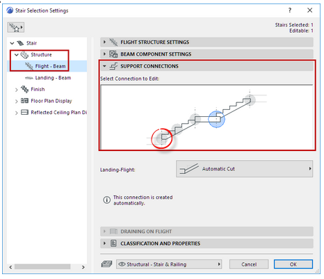

i am modelling a stair in ArchiCad 27 and am getting 1 10mm gap between the bottom riser and the stair structure. I cannot find a setting to remove it. Can you help me please??

I don't have Archicad open at the moment so this image is from the help file.
Have a look at the settings for the end support connection of your flight structure.

Hi Barry,
Thank you! That worked for me!

I am assuming you had a Vertical Cut with a dX value deeper than your toe depth and riser thickness?
Dwayno815
Hi Lingwisyer,
Yes that is exactly what i had. Im relatively new to the stair tool so am still playing around with the settings.
