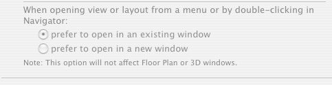

I must be missing a setting somewhere, because mine are not sticking for each viewpoint. I have turned them off a number of times and they "turn themselves back on". I was trying to track down why this is the case and was wondering if under "more options" in the work environment I should change my preference on how views are opened. Do you know of other settings I should mess with? Thanks for any advice, because this grid display is driving me crazy.

You list 1040 as your current update, I had the same problem until I updated AC. The other times I saw this was that either if I opened the view by clicking on the navigator and then opened it by selecting it on plan (or vice versa) and it would reset.

I'm in 1114 and it has not happened recently. Other options that I remember trying before it stopped was to close all windows, sections and details before exiting AC, doing a view update after changing the grid (even though it is not supposed to affect them) and creating a new elev/sect/det and make sure that the default creates the grid as i want if not eye drop from one that has the grid as I want. What I remember clearly is that it drove me nuts…
