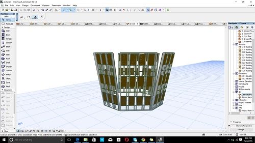

how can i intersect two incline cutain walls
i am trying figure out how can two inclined/slant curtain walls join at the corners.
2 REPLIES 2
Hi Alicechains, Did you tried the curtain walls editing tools in the Design Menu?
Design > Modify Curtain Wall > Boundary editing in section
sinceV6
Hi.
You can also extend the Curtain walls beyond each other, then use the split curtain wall commands and finally create common frames. Check the reference guide on how to do these steps.
Best regards.
