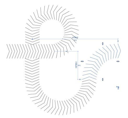

i find it difficult to display the detail of ramp on the layout plan
i don't know who to describe, but when i draw the layout plan, i need to show the center line of ramp and the arrow parallel line on bold side
please look at the attached image to understand and help me to make

Sounds like you just want to create a 'symbol' line type?
Draw the 'arrow' lines on plan and select and copy them.
In the Line setup dialogue, create a new 'symbol' line and 'paste' the lines in.
The 'dash' is the length of the arrow segment and the 'gap' is the space between them.
phthong12
thank a lot bro, it's that what i want
