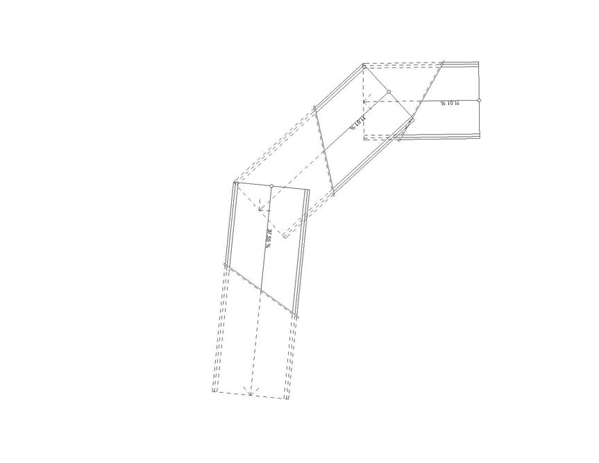

hi, i'm using archi-cad14. i found that the ramp just have straight & curved ramp. now i want to make my ramp in turning corner area, how to make or join the ramp in this case?

Actually i make the ramp no for disabled requirements,
i need to build up a multipurpose carpark from basement level ramp up to 2nd floor level.
For what you want to achieve I would make ramps out of a series of Roof's as the Ramp Object is not flexible enough to accomodate your cahne in direction. So by using the Roof Tool you can make a series of Ramps. It means adding Extra Detail later but It will achieve what you want to see.
You can use complex profiles and inclined beam to archive that
Regards, Ede
Or model it with a mesh and convert it to roofs with the free downloadable add-on (search in the Help menu).
