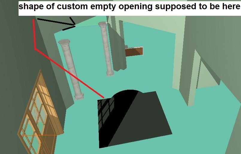

Hi everyone as i followed Graphisoft tutorial i knew how to make custom opening for doors and windows by making slab underneath of the shape we created and set ID :wallhole under tag and categories
but here i tried to make empty opening that i made its shape in slab and followed the same step but when clicking on empty opening in the setting it converted to be rectangle instead of the custom empty any idea how to deal with custom empty opening

yeah it should be saved editable Gdl script but it is showing solid in the design i want it to be empty opening like take the same solid shape

yes you right Karl For the problem before, i discovered that i left it saved as non GDL script as this was default but i changed it later ,
about the problem of solid door opening and empty one
i just discovered that i can create only one thick slab and called it wallhole in the ID than save it as door it give me result of empty door opening plus well representation of 2d on the plan here is the image
