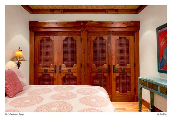

One of the big reasons that I don't just show them the ArchiCAD 3D view is because I need to add a lot of detail to the cabinets faces and other details in the room. It would take me a long time to model these details.
Do you have a suggestion for how to quickly (or easily) model details using like the ones in this photo so they would show up in a 3D hidden line view?
How could I quickly and easily model details like these?
Or model easily model cabinet details like this. This type of detail is why I hand draw the details in my 3D views. I just cannot figure out a way to quickly and easily model a house full of details like this using ArchiCAD so they show up in a 3D view.
I am open to any suggestions or thoughts on how to model this level of detail in ArchiCAD so the details show up in the 3D views.

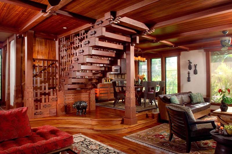

Or design and model details like this using ArchiCAD?

ArchiCAD Help: Virtual Building : Parametric Objects : Graphic Creation of Custom Objects : Saving Custom Shape Doors and Windows from the Project File
Anyway, I'm giving it a try to see if I can model custom doors for the cabinets and doors similar to the ones shown above.. If I can it will be great to be able to generate a 3D rendering of my designs as a tool for communicating with my clients.
I'm going to wind up using these custom parts repeated many times throughout the house. Is there anything that anyone wants to share with me about keeping the custom parts as small (parameterically) as possible so my PLN stays manageable?
