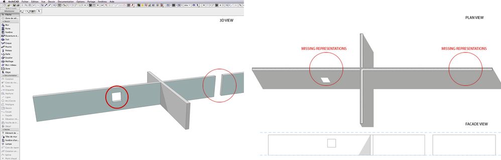

I've created a mesh form of a trapezoid cube and after that, i used it to subtract his form from a 3d wall using the Solid elements Operator.
My problem is that the hole created from the wall is only visible in the 3d view, section and facade view, but NOT in the plan view...

Thank you Erwin for your reply, but the problem is that i really need to use complex shapes for subtracting operations, hence the choice for the mesh tool...
Unfortunately, the result of SEO operations is not visible in the 2D of most of the elements.
The only element currently that will reflect in 2D the result of SEOs is the Morph Tool. So something has started in this direction...
roof and shell tools also display this behavior. I am at a loss to understand why it is so difficult to assign these essential proprieties to all the tools.
