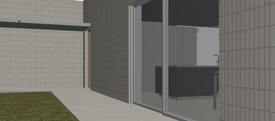

in 3d view all disappears when show all layers icon is clicked
normal 3d view

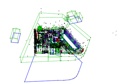

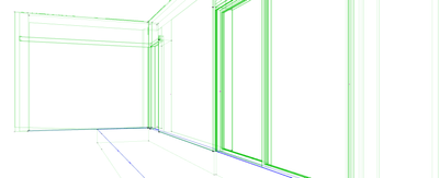

the same 3d view after I click on "Show all layers"
it seems that all the elements are here, but they just don't show properly because i can select them but they are totally transparent / white (?)

No, because the same thing happens from any other view onto the model (aerial view as well)
nothing can be seen but tihs x/y/z icon
But then i can select the model - it is here
Try turning on just a few layers at a time, until you come across the one that causes the problem.
Then look in that layer only to see what is there.
