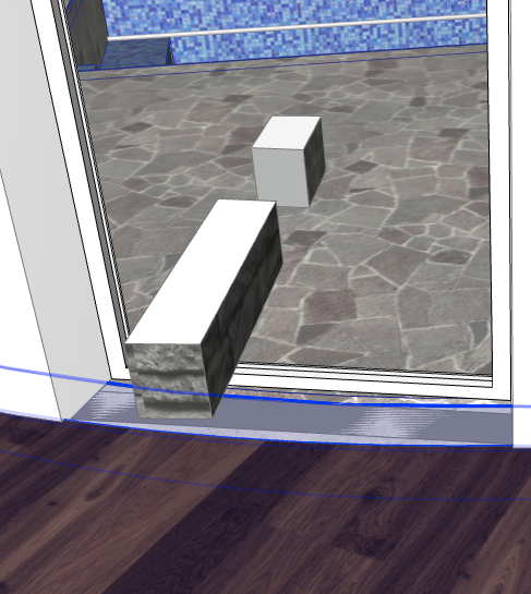

All the slabs going all the way into the window is unseen.
That is a big problem for me cuz i want the floor to go all the way in the window. (Did not have this problem in AC 16)
Anny one who knows why.

seems to be a topic of the material - cutting-nr. try another material to proof..
Hi
Thank you.
That was the prob.
AC 17 came upp with new skin layer feature with smart cutting.
In AC16 we could make the finish floor go in in the windows. Not any more
