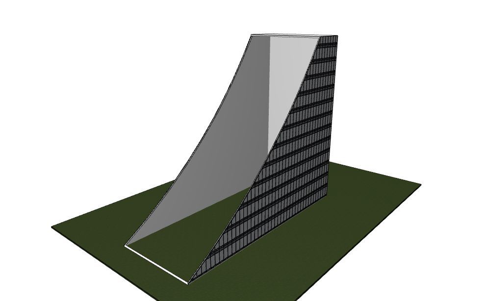

Below can you guys see a picture. I'm trying to make a curtain wall at the empty space joining the both sides. I tried with defining boundary line, but can't make the ends meet. If somebody knows that would be great

You mean the curved part?
Just draw the profile on your floor plan (you can draw the curve in an elevation an then paste on floor plan or use the elevation as a trace reference) using any of the curved methods.
After it is done, just rotate it in the 3D window and move to the correct position.
