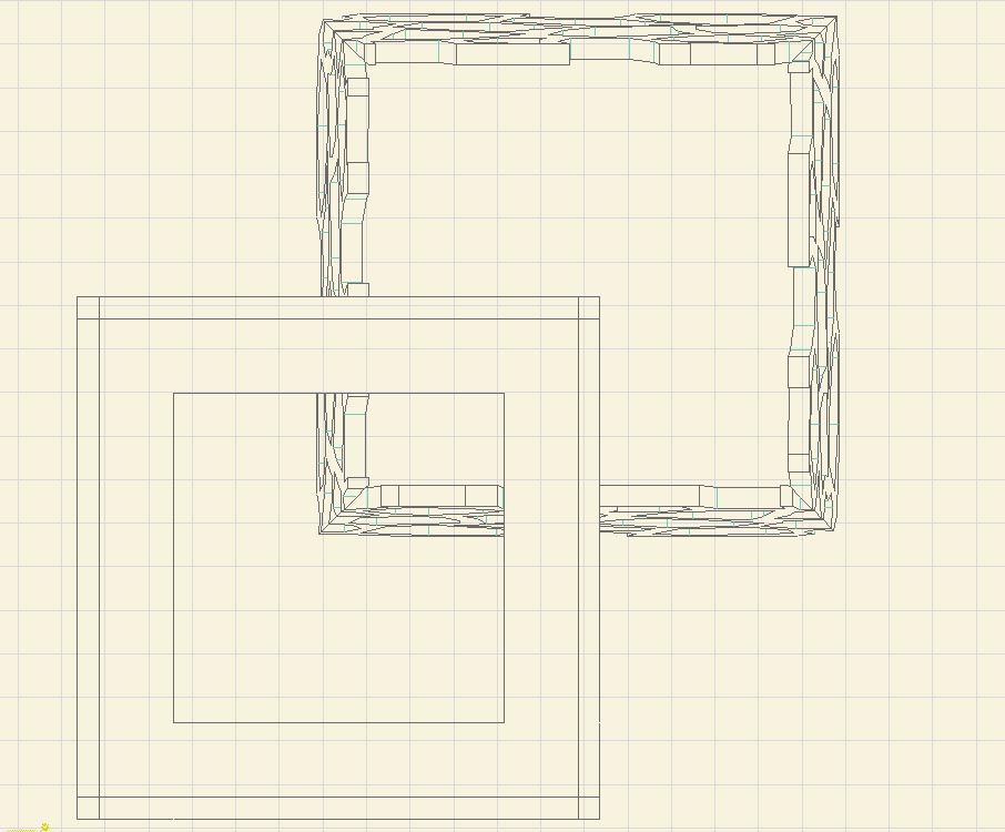

i want to make building skin like the one michel rojkind did for the earth mark tower or like the "bird nest" stadium beijing...
do anybody knows how to do that on archicad 10?

I expect they would have used a modelling program like cinema3d or 3dstudio to actually model such complex shapes and then imported it in.
It is possible to do a slightly less complex version directly in AC10 by using a combination of profiled walls and SEOing shapes out of it. You could then make a library part out of it and manually add in some code to make it storey sensitive to display properly with the floor plan cutplane.
Below is my proof-of-concept attempt which took about an hour to make. (Mines the one on the left!! )
Hope that helps!
Pete.

To be honest, I only got it half working and it was a fudge at best. (See picture below!)
I think it should be easy enough to create a 'universal' piece of code that you could drop into almost any library part to make it cut plane sensitive.
The route I was attempting (although perhaps wrong and very inefficient) was to set a cutplane to the FPCP height in the library part that cuts off everything above, and then display the model with a thin pen. This would give the outline of the part. Then I created another cutplane that removed everything below and above and just left the cut, which I wanted to display with a thicker line. When both were overlayed it should have given a correct view of the library part.
Maybe we should ask the question in the libraries and GDL forum. I'm sure someone with more expertise could figure it out in 5 mins!
