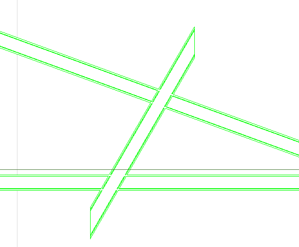

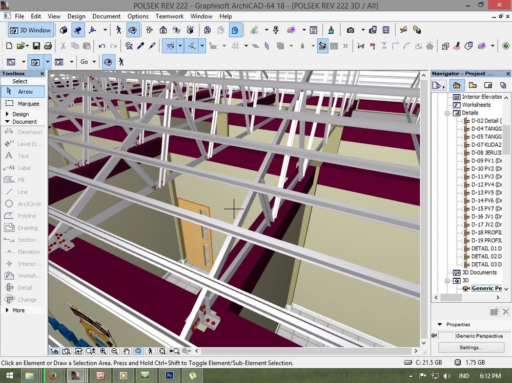

i want to make truss with my own profil, thus this profil is not exist in trussmaker.
an archicad master has shown me his work, but he does't have any time to teach me how.
he didn't use add on (like cad image) . he just did maunally
i hope any masters would like to share the way to make the truss.
i sent the file (jpeg) that i got from him.
thx.

i made the truss using beam with profil manager.
but my problem is
i couldn't trim it.
is there a way to trim or i should make the specific length truss without trim?
