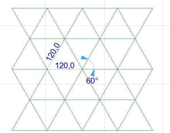

Hi friends,
How do you make an equilateral triangle curtain wall like in the picture with using curtain wall settings?

If the CW won't do it SEO is presumably the way to go.

Thanks, that worked. Now after a few SEO, the archicad is moving slow. Is there a way like is in 3DS Max to collapse the stack, meaning all the operations done will collapse remaning just the object edited so that it will run smoothly.

Save as a library part. If you set it to non-editable/binary it may be a bit faster.
Be sure to keep the original stuff (on a hidden layer or something) in case you need to edit and resave the part.
