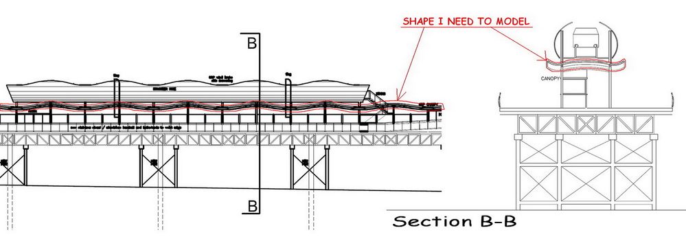

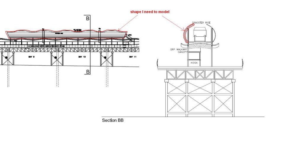

I need some help with modeling a funny shape side screening. I'm using Archicad 9. I'll try to attach some images so you can better understand what I'm after. If anyone could help, it would be very much appreciated.
Thank you in advance,
Regards,
Danivici

Could you please help me with this as well? I just can't figure out what profiles should I use for SEO...
(I'm using Archicad 9)
Regards,
Danivici

Then create two Walls perpendicular to each other and make a SEO intersection between the two.

danivici wrote:Are you trying to produce something like the attached image?
Central Innovation

Create a profiled wall (using a wavy profile that matches the elevation) by magic wanding a polyline (the polyline has the shape of the section B-B). Then you can save the result as an object (and thus achieving the rotation to horizontal position).
