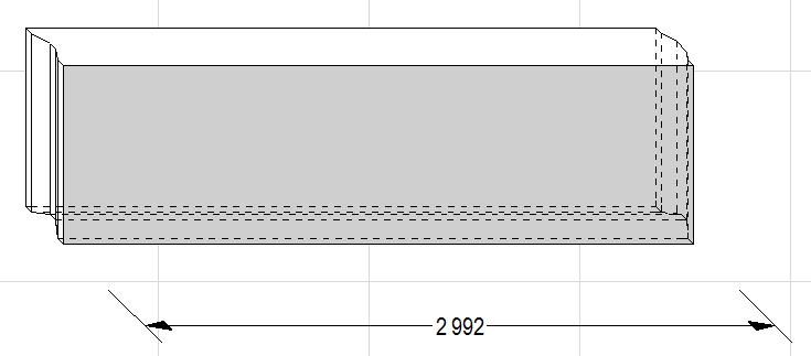

Hi!
Thank you for your replies!
I've managed to get the hidden line look in my 3d documents. But I have trouble getting a wireframe look ...
What I'm really striving for is to get a dotted or grey line representation for all the hidden lines.
See my attachment
I apologize if my original question was not that clear.
Thank you!

This is possible with options in the hidden Special menu, seen in the attached screenshot.
Choose "Special Hidden Line"... and select the desired linetype. Then select "Show Special Lines" to toggle the hidden lines on or off. (It is kind of weird that in 12, there is no checkbox in front of Show Special Lines to let you know that it is enabled.)
The result is captured just fine by the 3D Document.
To find out how to get the Special menu, just use the forum search feature for 'special menu' or 'show special menu'.

Hi!
Thank you guys!
Got it to work (almost), I liked the regedit hacking 😃
I'm not able to change linetype once I've activated special lines... is it something that I'm missing? some pen setting somewhere that overrides the selected line, (seems like the line type has to be chosen first, and when choosed it's not possible to change without restarting archicad?)
And it also seems impossible to get rid of these hidden lines. It does not matter if I click "Show special lines" rebuild click it again, rebuild... still there? 😃
This maybe explains the hidden nature of this option 😃
Anyway after restarting archicad and choosing the dashed line before enabling the special lines .. everything works out as I wanted it to do!
Thank you very much!! Saved me plenty of time!

Glad it worked for you (mostly). I had none of the problems you mentioned - when I change the linetype, it changes in 3D. When I toggle the 'show' option, they appear or go away as they should.
When you say that you did a 'rebuild' did you try 'rebuild and regenerate'? Either something is amiss with your 3D window rebuilding, or perhaps with your graphics card ... or maybe it is just behaving differently on Windows...
