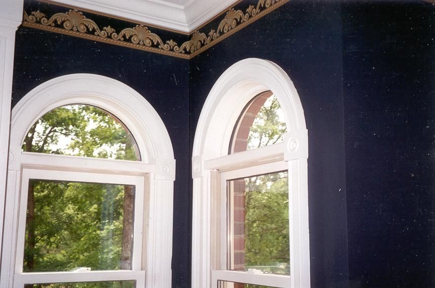

hey...this is irfan from Bahrain...im facing big problem in archicad...im civil engineer and im using ac13...im try to making moulding arrount the window.....how can i make..becoz i had semi arch window...and around it moulding...plz help me in this matter or tell me method or any tutrial...may b i will get...wait ur gud reply....
