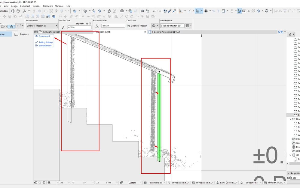

I want move railing post according to cloud , I cant did not move , and not showing move or properties option, how to move this , please help I'm new here

The posts are set based on the position of your nodes and Inner Post spacing. If you are trying to match an existing railing, it would probably be best to put a node where each existing post is. In this way you will have more control of it's placement. The overhang at the end is then controlled under your Toprail / Handrail End settings First Extension.
