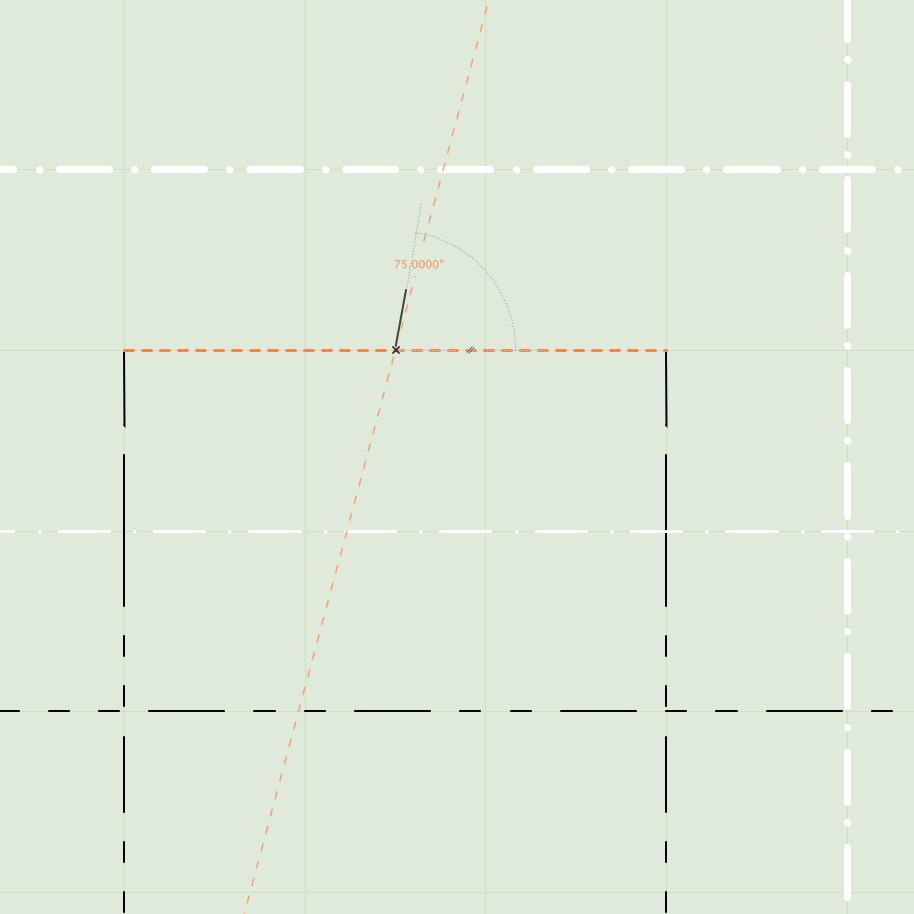

Eduardo Rolon
and you can draw a guide between 2 points just like in SU. Start a command (line, wall, etc) hit the Guide Line Shortcut key, draw the Guide line and in the screen shot you can select the midpoint of the guide.
Eduardo Rolón AIA NCARB
AC29 US/INT -> AC08
another Moderator
Eduardo Rolon
midpoint…
AC29 US/INT -> AC08
another Moderator
