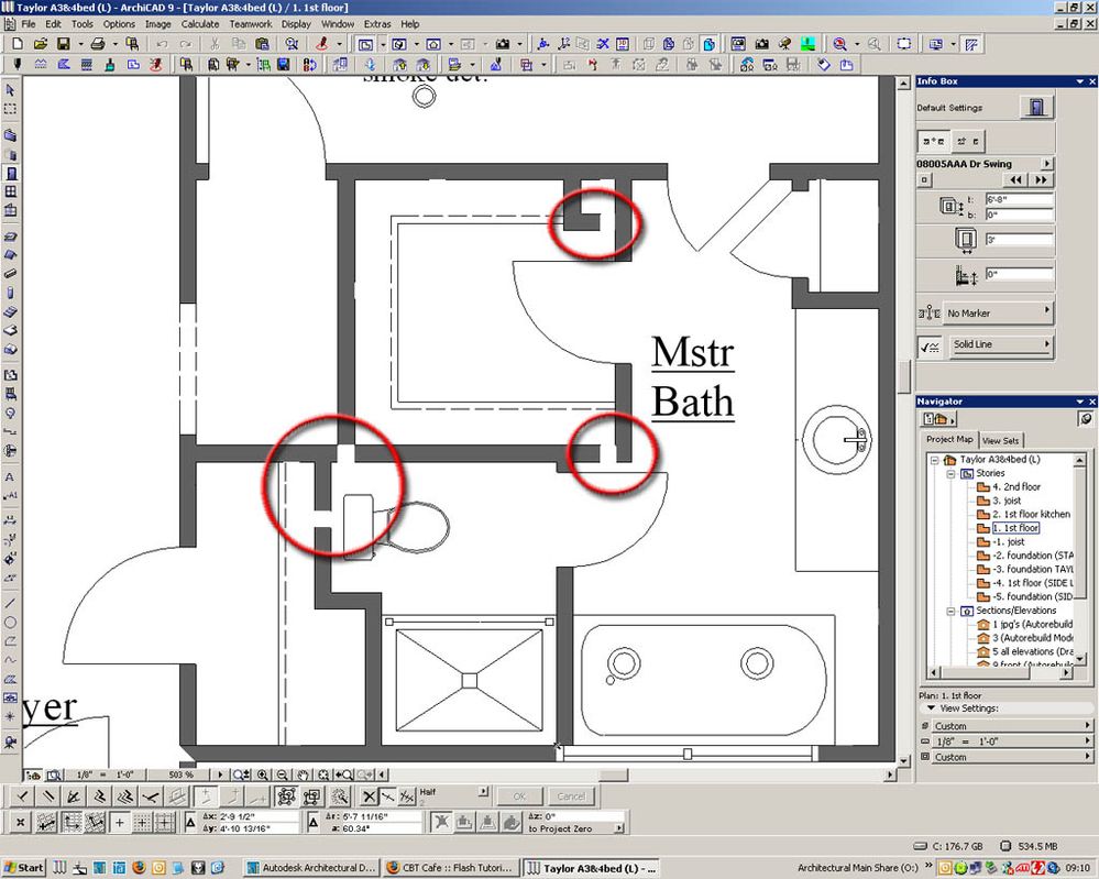

odd broken wall problem...
I've just gone back to edit this file left by my predecessor, and when I open it (tried it on 2 machines) some of the walls have odd breaks in them, it's driving me up a wall (no pun intended) and was wondering if anyone here knew of this problem.. or hopefully a solution.

Daniel,
we get this alot....turn all of your layers and see what elements are overlapping walls...take note of what layer they are on...then go back to your view set...take a look at that layer hiarchy number...bump it by one make sure your either update the layer combination or redefine the view....
