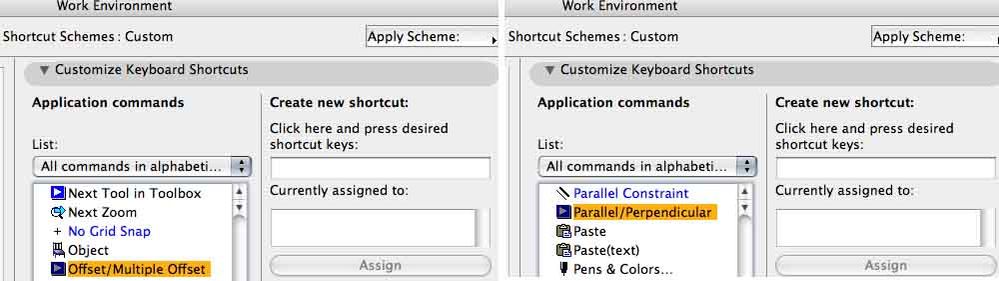

Dwight
The setup requires using "Keyboard Shortcuts" - all commands alphabetical..
Attached is the list.
Dwight Atkinson
Try using the guidelines. The explicit parallel and perpendicular commands are nearly automatic now.

You might also consider turing back on the control box which will indicate the "toggle" of the parallel or offset. Remember you can import your previous shortcut from 9.
Dwight
Using the shortcut already does toggle - but certainly the new guidelines help make perpendicular and parallel axes as easy as pixies dancing on the work surface.
