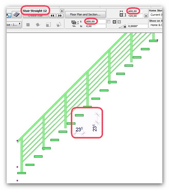

This stairs were made with standard stair tool (NO StairMaker):
