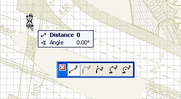

please ...the Arc/Circle tool disapear !!!
hI
i HAVE A STUDENT VERSION OF ARCHICAD 16 64 BIT
AND AFTER i CHANGED IT FROM 14...WHEN i DRAW FOR INSTANCE
A SLAB WITH PLYGONAL DRWA METHOD : LINE---ARC---LINE
THE SMALL WINDOW TAP DOESNT SHOW UP ANUMORE DURING DRAWING...
THE ATTACHED A PHOTO....HOW CAN I FIX IT?

Even though I've not had your particular view problem, I've had other issues with the screen display (2d&3d) in 16 but not in earlier versions.
I believe because of increased demand on the video card in 16, prompting me to order a newer one than you currently see in my spec's.
You might want to list your machine + video card spec's.
Have you updated you video driver really recently? Although that did not fully help all issues I was having.
I dont think it has nothing to do with graphics card. and yes....it is updated and still the Arc tool palette just disapear after i leave hift botton...
damn ! I cant use this version like that
rocorona
The Pet Palette can have a static position or a dynamic position (following the cursor). Could be that it is static in an odd position (very near to the border of the screen, or even outside) Try changing the setting to dynamic, in Work Environment>Dialog Boxes and Palettes
You can also try switching to a standard WE.
