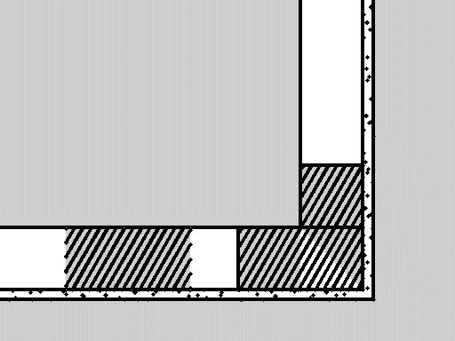

zucoc wrote:
1. How can I create polygonal shaped columns?
If I use 2 rectangular columns the separation line between the 2 columns will be visible, which is incorrect.
If I use a composite wall then there will be no separation line at all between the concrete fill and the empty fill of the brick wall.
2. Why there is no SEO interaction between slabs and walls?
Shouldn’t slabs cut in the walls?

Link wrote:
You shouldn't even need to use a ploygonal wall for this. Just a regular wall on a layer with a different layer intersection priority number.

zucoc wrote:
columns and beams are automaticaly substracted from walls but slabs are not
