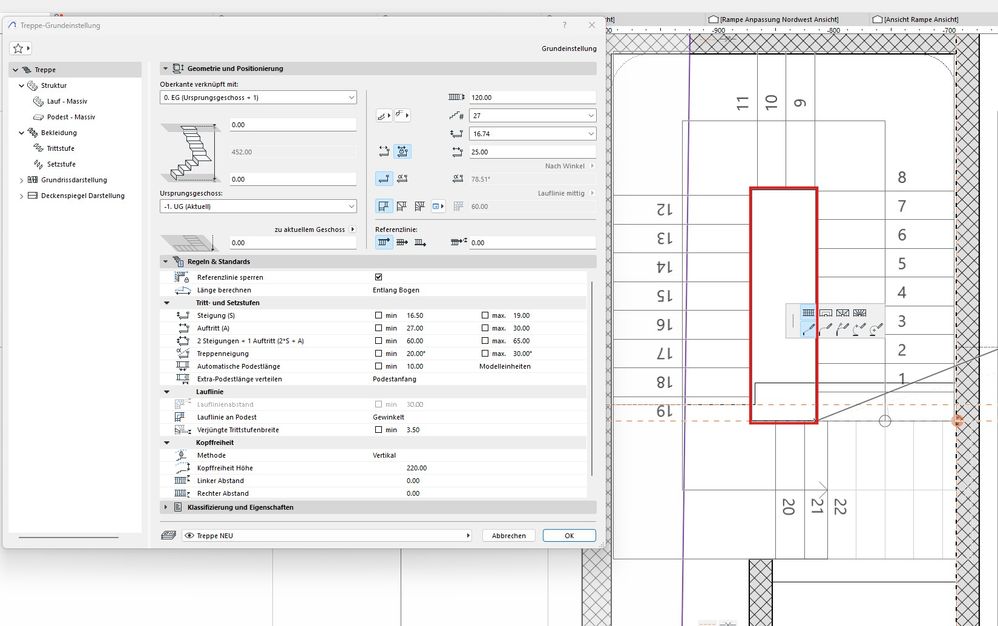

For some reason I can't create these stairs. i 27 stairs for the height 16.74. The tool doesn't let me continue building the last stair line as shown in the added photo.
Could someone help me understand what I am missing?

CosminF
Just so I understand what you are trying to achieve: do you want your stairs to "spiral" on top of themselves? That is not possible in Archicad, you will have to split the stair into multiple parts.

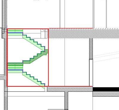

I duplicated two sets of stairs to show what I mean. i have a one and a half floor (from entrance to garage), the height difference is 452 cm
I try to make a normal staircase, not a spiral. just a normal rectangle.
 In my first message you could see that after stair number 20 i am not allowed to pull the direction of the stair upwards.
CosminF
Yes, bad wording on my side.
I meant spiral as in a stair that overlaps onto itself - even rectangular in shape. That can't be done out of one single element. You will need multiple stairs to achieve that.
