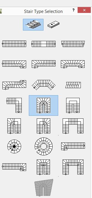

I am trying to create the following custom stair.
I do not know what the issue is, but I cannot add new steps to endure normal steps rise and length. I tried modifying the rise and length and one of them is forever wrong. I assumed it's the tight range of the stair formula, so I loosened it, just to see what happens.
Is it the walking line that needs to be different?
Thank you.

I should try to make this clearer. How can I make the steps rotate like in the selected stair pictured below? 12/15 steps is too less for this stair.

Have you tried using the "CUSTOM STAIR" option?

Of course. The first picture shows the custom stair, its shape and how the steps result. I wish the steps would rotate like the ones in the stair from the second picture.
You need to make the line of travel curved
