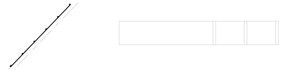

I'm having problems trying to get a clean look in elevations/sections
Basically, the integration from columns with walls, even if they share the same material, are on the same layer, share the same # in the layer settings, never looks like in one piece. The lines of the columns always come through.
This problem is forcing me to draw the elevations/sections in 2D !!
any ideas ? Thanks !

It should work if you make sure their surfaces match exactly .
But when I want full column /wall integration, I usually draw the columns with the wall tool, but on the column layer. The column you show is nothing more than a thick wall anyway. Much easier!

OMG ! you are right !
thank you !
