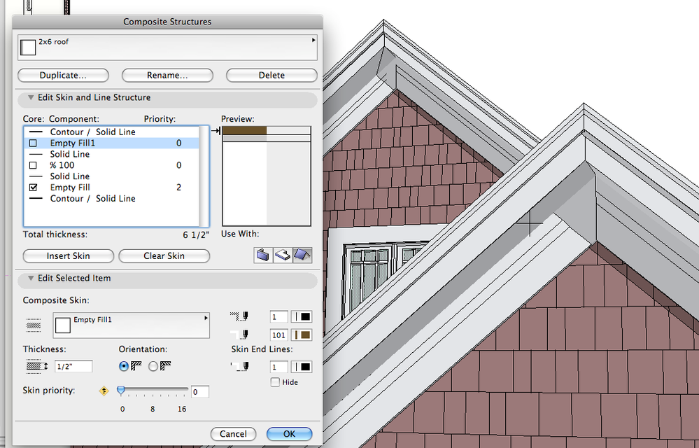

I may not understand the question, or what your doing now, but are you using composites? If not, then you might want to learn about them since they are essential to get the most out of AC. For a roof, all you need is a composite of the appropriate thickness, and then you will have all surfaces made by simply placing the roof. You can assign different fills/colors to each surface.

Rick did you use composite to achieve the cornice for the roof elevation of the attached picture?.
whatever the answer is how do i get that done since the default setting of roof will produce basic straight shapes. even when you choose composite for the fill option.
Femi
Rick Thompson
That is actually an object for that purpose, that I got from Smart Parts Trim Library. A very handy object for residential construction. I actually duplicated the "base" object and renamed it for my use.
