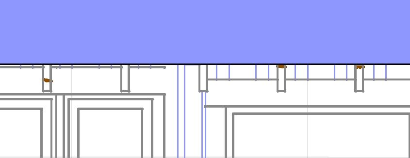

I made some rafters, but got these mysterious little marks along with them...they are associated with the rafter tails, and delete with it, but not separately. Are they representative of kinks, do you think? Or some (somehow) uneven roof slab from which they were generated?
2 Replies 2
Zobi,
If they are made from roof slabs then it could quite possibly be the material hatching you have associated to the surface off those roof slabs.
Try choosing another material or edit the material to change/remove the hatch pattern.
EXACTLY.
Thanks so much.
