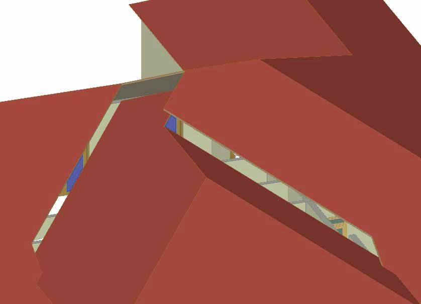

is there any tool/trick to merge roofs automatically??? thx in advance

Go to ArchiCAD help. Do a search for "roofs". Chose "Creating Roof Intersections"
Also, sometimes it's easier to let ArchiCAD create the roofs automatically and then modify them.

thx woodster....thats what i do....but, any one of those 'magic wand' or 'space bar' hidden quick procedures?

Select one roof and ctrl-click the edge of the roof you want to change. The roof you ctrl-click on will trim or extend as needed to the point where it would intersect the selected roof.

thx a lot....and use the 3d view
