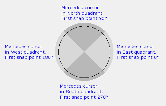

Trying to draw a five point star.
1. draw a circle
2. Set snaps to 5 divisions
3. draw a line from one snap of a star to another snap
4. all the snaps change!!!!!!!
doesn't matter what the settings are.
Anyone? Am I being stupid or is there a problem in AC11 with snap points?
TIA
Adri

Looks like ArchiCAD is snapping to the nearest quadrant, depending where you hover: 0, 90, 180, 270.

As Link said, this is a question of quadrants.
First, put the Mercedes cursor in the correct quadrant, according to your choice.
Hurry up to draw your lines, before snap points disapear.
If they do, while drawing, put back the cursor in the ORIGINAL quadrant, otherwise snap points will change.
A bit confusing. Even more confusing if you rotate the circle. In this situation, i think the "feature" is buggy.
A simple improvement could be to allow just one position for the first snap point, for eg 0°.
Then, all snap points should rotate accordingly to circle rotation. No more infernal jumps.
