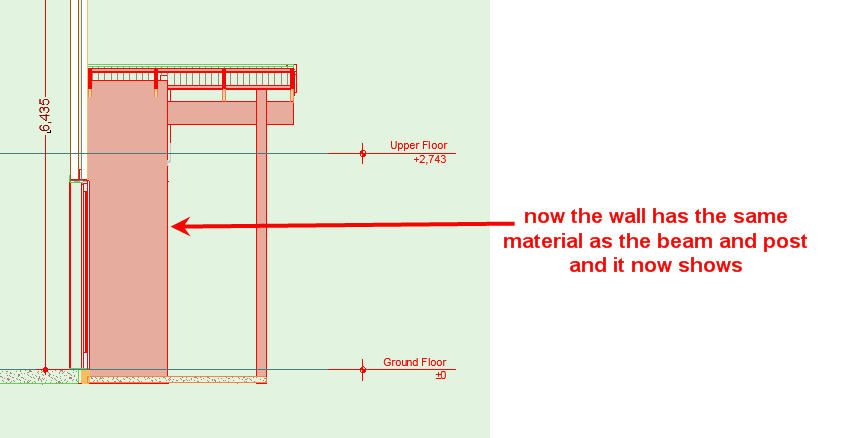

This is interesting.
I have just come across a plan that has % fills attached to a material in the elevation and they show up fine.
So it is possible.
The mystery is that these are new fills that have been created.
If I swap this new % fill with the original % fills (25%, 50%, etc.) then the fill in elevation disappears.
If I add the new fill to a material and then attach that to an element the fill appears.
So it seems like there is something wrong with the default original %fills.
I have tried to create a new fill from these original fills and they won't show either.
I have also tried to create a new fill from the solid fill and given it 50% transparency and it will not show either.
So the thing is to now find out how these new fills were created.
I will be sure to post back if I find the answer.
And just to prove the wall can have a % fill on the material.
OK I have the answer.
You need to create a new fill but make sure you choose the "Solid" option.
Once created then you can set the level of transparency %.
Attach this new fill to your materials and it will show up fine in the elevations.
