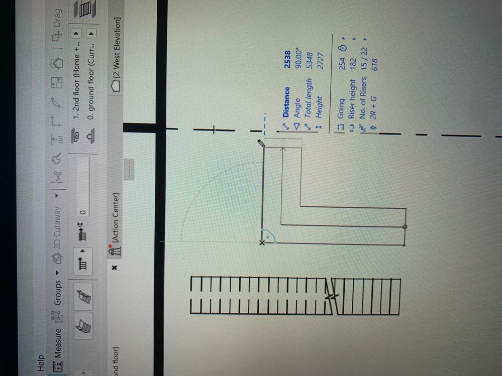

Can anyone help me why can I only draw the straight stair? When I try to turn 90 degree to make the U stair it shows like that and doesn't work. Thanks

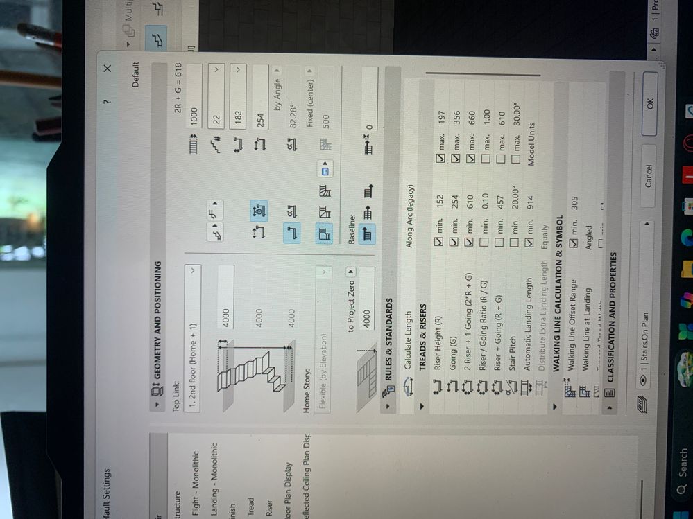

Try placing the reference line in the center of the staircase rather than outside, and also modify the value marked by a "?" and the one marked by a red arrow into my picture.
