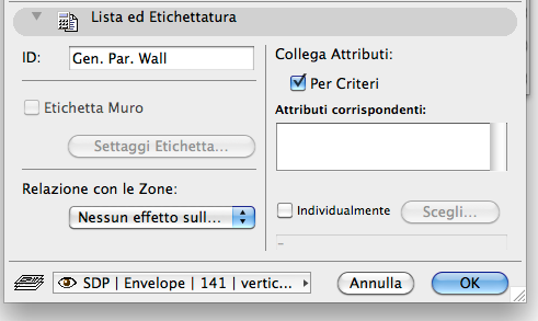

...I found out that part of the zone volume is subtracted by a wall, see picture attached.
It is weird, because I did not run any solid operation between the two elements
also, the wall settings for "relations to zones" is set to "no relationship"
how do I get rid of this interference, if it does not depend on the "relationship to zones" or on a solid element operation?
