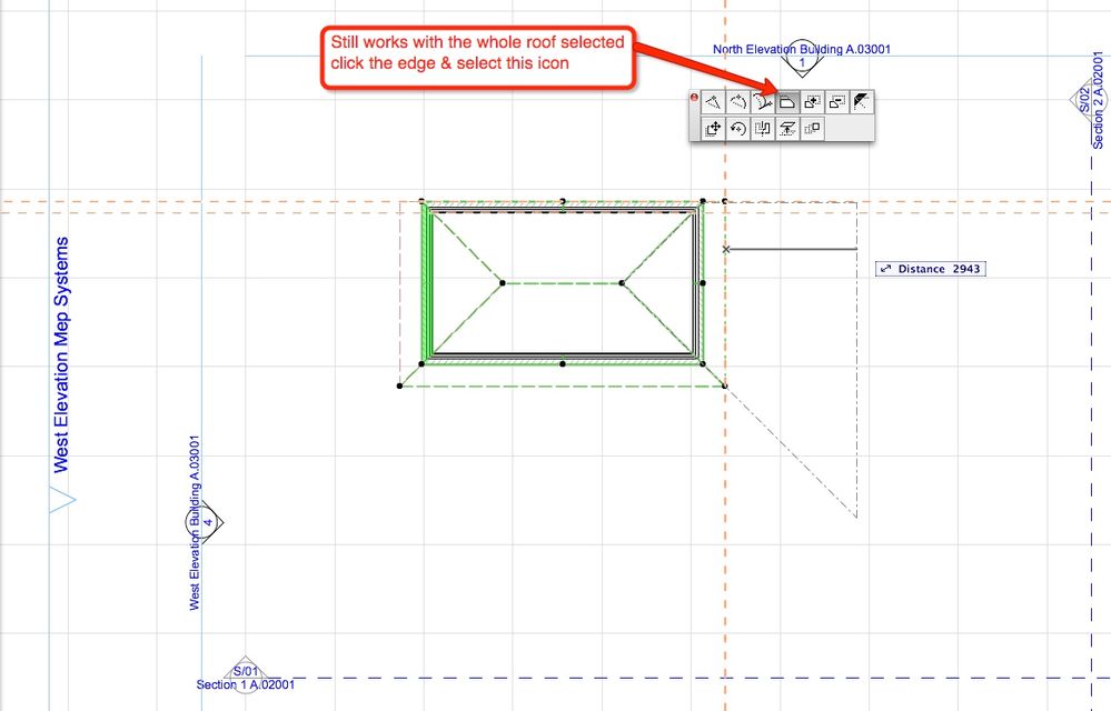

Hello everyone Glenn from Australia here.
I created a roof using the polyroof tool and choose 300mm for eve overhang. The roof was created fine but there are parts of the roof I need no eves, and for the life of me I cant work out ho to remove the eve from that part of the roof.
Please help
cheers

Mercedes on the roof edge and use the edge offset button in the pet palette. All polygonal entities edit the same way ...

Thanks Karl but the edge offset button is not visable in the pet palette and I dont know why

You are either clicking a corner or the roof slope orientation line [that often coincides with the bottom edge of the roof.]
Dwight Atkinson
edit the individual roof plane edge or Node

Does not matter which part of the roof I click I only get drag,rotate, mirror, elevate and multiply. No other options seem to appear.

Thanks I can see what you are saying. But for some reason im not getting all the buttons in the pet palette. only the bottom ones in the picture of the previous post. Cant work out why?
you are probably selecting the wall or something
Hover the mouse over the edge & use tab to alternate the selection of the plane
No matter what I do it seems to select the whole roof not just the section like in your picture. tried tab didnt work either as soon as I would click the whole roof was selected again.

See pics or Manual
