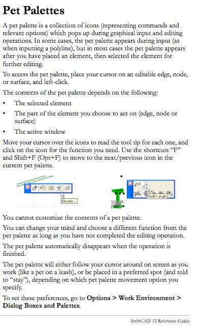

Hello everyone Glenn from Australia here.
I created a roof using the polyroof tool and choose 300mm for eve overhang. The roof was created fine but there are parts of the roof I need no eves, and for the life of me I cant work out ho to remove the eve from that part of the roof.
Please help
cheers

thanks for your patients but I still cant get the extra options to appear when I make a roof using the polyroof tool.
Out of ideas other than trying to select it in the 3D window with a top projection & trying the same thing but this can be awkward
You should get a similar pet pallet for slabs etc after selecting & right clicking on an edge with the mercedes cursor also
seems to work when I dont use the polyroof tool to make the roof if thats any clue. But I need it to create the roof I want
thanks
rocorona
"Ungroup" or "Suspend Groups".
This way you can select individual roof planes, instead of the whole roof.

Thanks everyone for your help ungrouping worked
cheers
cremsberg
Is the roof that you are trying to edit grouped with other elements? If so, try to suspend groups or un-group. Is the roof layer locked? If so, try unlocking. I know this sounds basic, but I've suffered this myself.
