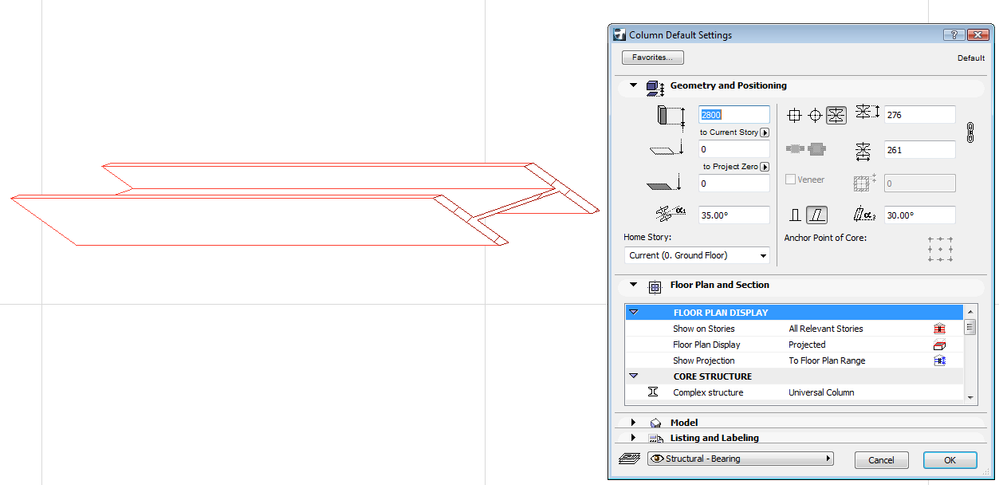

When I draw beam with profile in the plane I can see outer line of it and center line
any way to see every visible line in it

Unfortunately not.
You can make a library part of this fairly easily and then you will see the lines.
You can then lengthen it as necessary when you stretch in one direction only. Assign it the subtype of beam.

You could model this using the Wall Tool and for a Wall you can set the Floor Plan Display to "Projected" so you will see those lines.

thank laszlonagy but wall have not angle to skew verticaly.that what I need
How about a Column?
You can create a slanted Column and it can be set to Projected.
The only restriction is its slant angle to horizontal must be at least 1 degree.

I try column nothing right ??? please can you attach pic of that
I need verticaly profile (beam,wall ,column....) with slant up angle
and why when select projected in beam visible line not appear.

Here is an example.
On a second thought, maybe this is not what you are after because it shows the Cut surface. So you would have to increase the Floor Plan Cut Plane to be above it. But maybe you don't and it works.
