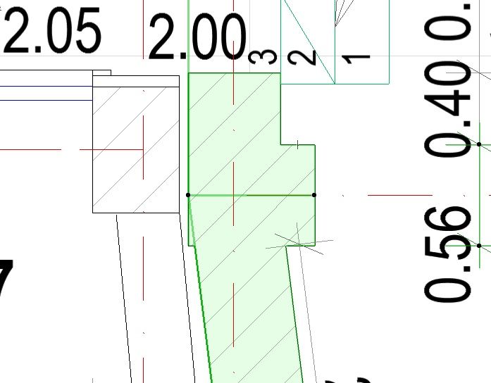

I have two curved walls that intersect. Their axes intersect as well, as is clear in the image. However, there is a line remaining. How do I get rid of it?
Thank you.

Near the two previous walls I have another two that intersect and again a small line in between is visible. This is issue no 2.
This is issue no 3. Three walls intersect and I wish to trim one of them, but I cannot. Why?

The first two should clean up automatically in ArchiCAD 17 depending on your intersection priorities and reference line location.
The third one is a little hard to tell what's going on, but doesn't look like it should be a problem. You could make it out of three walls or a polygonal wall and it will all clean up.

As far as the first intersection is concerned, the two reference lines are situated on the outside of the curved walls and intersect perfectly. How do I check the priority?
Thank you.
I found the wall priority option. All have it set to 8, so it does not differ between intersecting walls.
