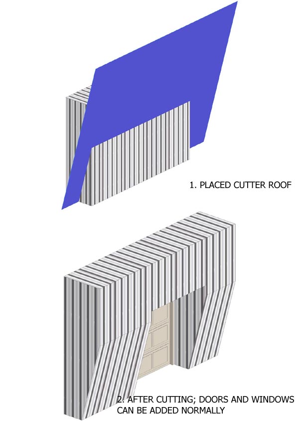

Please help me with this wall. As the picture show below, I need to building it in ArchiCAD. I don't know how to build a wall tilted in angle.

Place a zero thickness roof plane starting from the bottom of the wall; tilt it accordingly (best done in 3D window), stretch the wall to go through the roof (again best done in 3D window), trim to roof (bottom in this case), put the wall back to its desired height, hide the roof layer, viola and other string instruments!

Thank you, Djordje:
I almost feel crazy to figure out to make this wall. Thank you for your help. I'll work on it to see if I can make this work.
Djordje:
Thank you so much. It finially work.

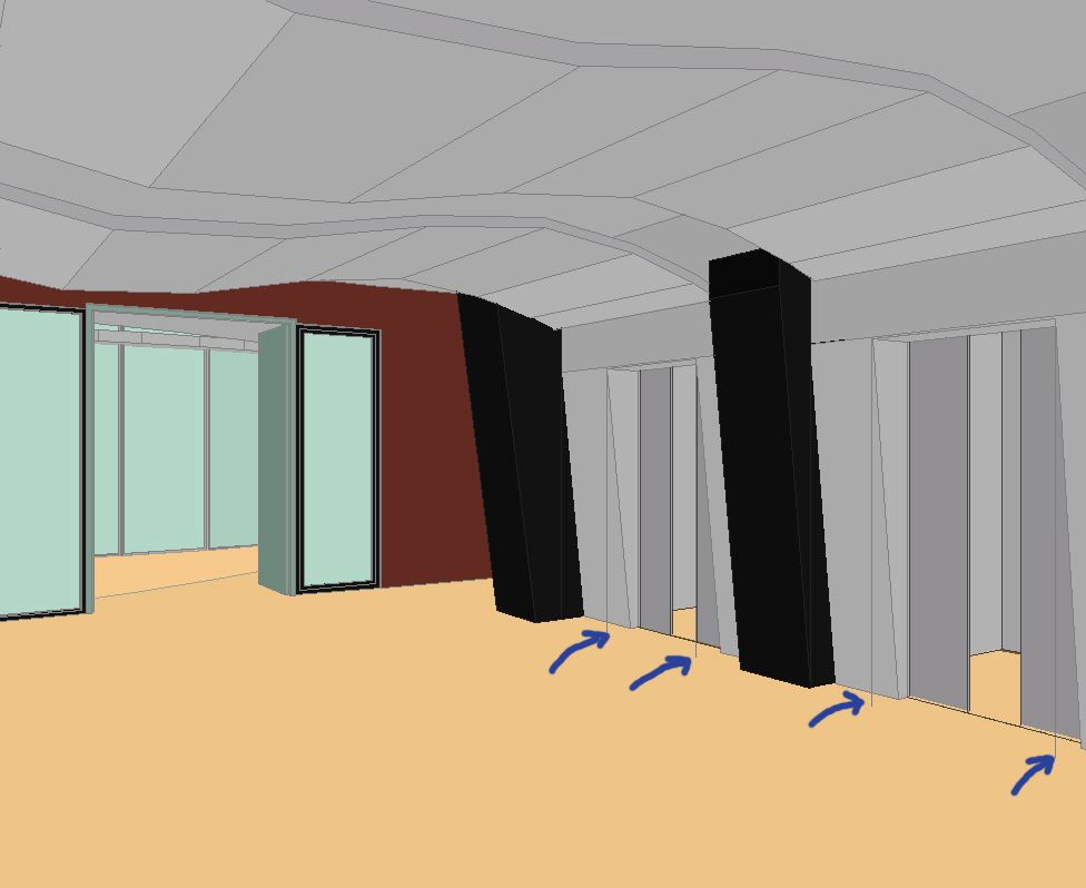

I have one more question.
After i render the model, I can see the cutting line. Is there is anyway that I can delete those line? I think I might not expline well, so here is the picture. The blue arrow point the line that I want to delete
Djordje
Moderator Emeritus
This looks like an analytic shaded view to me. If it is, turn the contours to best. All the joints of the same materials should disappear.

Those lines aren't rendering anomalies, they are floating in space not and not on the surface. They appear to be 3D lines drawn by the door objects.
My guess is that you did not trim the doors as you did the walls, or, if you did, that it didn't affect the lines. I don't how SEOs deal with lines as part of a target element. Surfaces (and of course lines etc.) will not work as operators.
