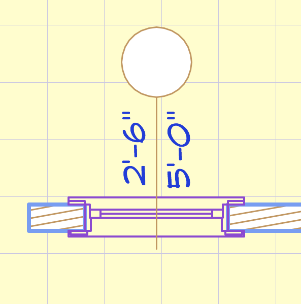

Is there a setting to get AC14 window sill and stool to display on the floor plans, as well as casings? I had this working with AC10 library parts (see attached), but haven't been able to do it since.

Thanks, Adrian, but I can't find that this works. Oddly, things look as I want in the settings window preview, but not on my actual plan. I have tried with and w/o composite walls. I've tried 2D Representation at Detailed and at Scale Sensitive, but neither shows the sills the way I want.
Does changing the Model View Options settings help? (Document > Set Model View > Model View Options)
