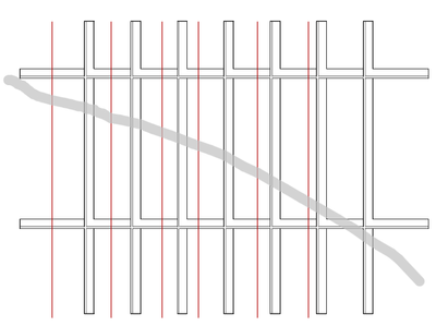

This option currently allows elements to be trimmed or deleted one at a time. I suggest making the deletion like the selection process, allowing users to delete or erase multiple elements using the same selection methods:
We can also decide to remove elements as follows:
yesterday - last edited yesterday

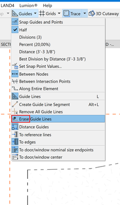

This drag-to-erase method is actually possible with the "Erase Guide Lines" option in Archicad:
The drag-to-erase functionality should also be available for other architectural elements:
