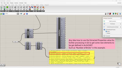

Any idea how to use the Extracted Properties value for further processing in Grasshopper to get some new elements to be get defined in ArchiCAD? I am talking especially for the "Classification & Properties" related things.
In the example below, I was willing to use the number of bricks extracted value to be used further for reserving the space for storage of construction material on site as part of the project management. Was willing to add the total number of bricks from all the walls as per their types and so on.
Note: I can use the interactive schedules but then ti's not able to define the area / volume needed for material storage in the godown/ shade automatically.

Thanx for showing interest in my work. I am attaching the video clip to explain the entire task for extracting the required text field from the properties list and then further use the same to achieve the required end product. Hope you will find it suitable.
https://youtu.be/kpqUbpgV2dI kindly visit on my YouTube channel.

Finally, I was able to manage to solve the above problem in GH 😊
if anyone is looking for the similar solution do let me know I will share the equations.
