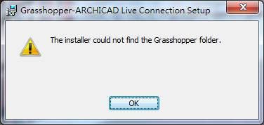

I'm trying to install grasshopper live connection plugins. However, system alert that it can not find the grasshopper folder.

On my computer the Grasshopper folder you need is located at:
C:\Users\<Profile>\AppData\Roaming\Grasshopper
This folder includes a "Libraries" folder and ARCHICAD installs its files into its own folder within this "Libraries" folder as you can see on that attached screenshot.
