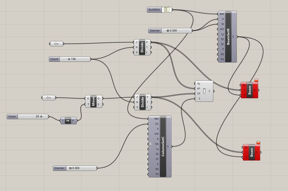

I am trying to complete some basic tests with the GH connection and I am coming up with this error:
1. Data conversion failed from Point to Curve
Not sure what it means. I have tried rebuilding the script but it doesn't seem to work.

the beam component is expecting a curve, but you input a list of points instead.
Grasshopper is quite intelligent in converting data types on the fly, but as you see in this case, the conversion from a list of Points to Curve is not implemented.

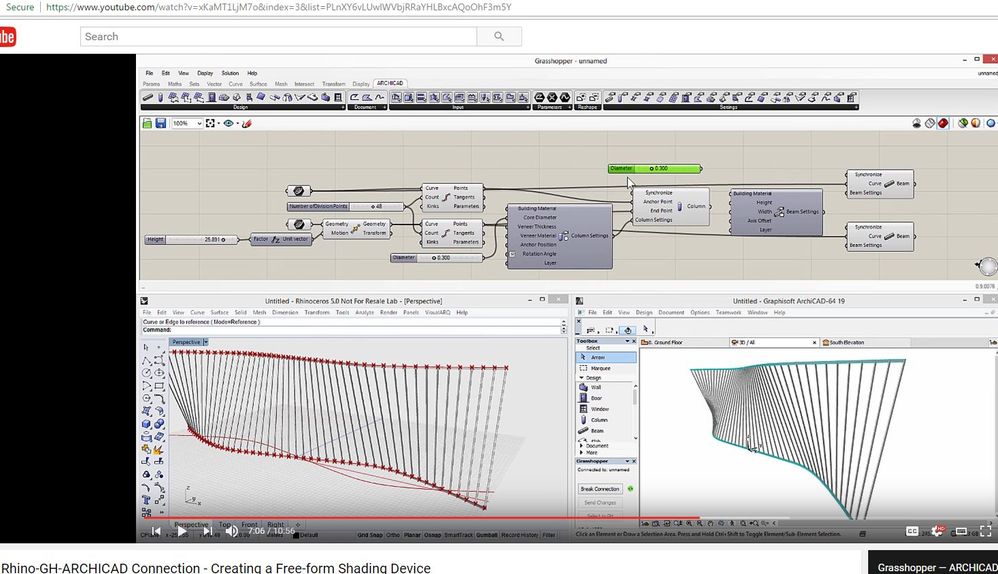

How would I fix that issue? I now the obvious answer is to make it a curve but how would I do that? I am following this example.... https://www.youtube.com/watch?v=xKaMT1LjM7o&index=3&list=PLnXY6vLUwlWVbjRRaYHLBxcAQoOhF3m5Y

use column components for vertical elements and fit them with the points derived from curve subdivision
use beam for horizontal ones, this time using curves.
the video you are referring does is this way
I guess your error is that you are trying to create the vertical component with the beam tool
