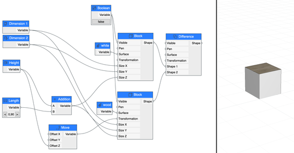

You have to make a scheme with surfaces.

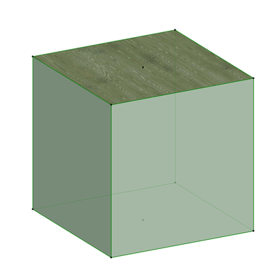

The unfortunate thing about param-o is that each block can only have one material. If you want to calculate area of a slab, you have to create a param-o object with a different material on one side. (possible by using "difference" between two blocks with different materials.
Param-o setup for a block with wood on only one surface.
