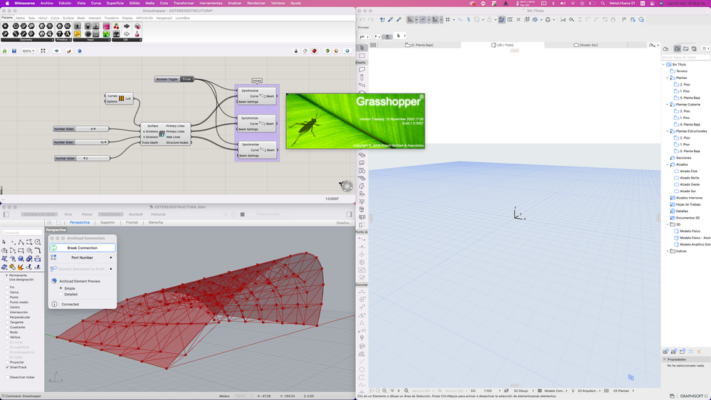

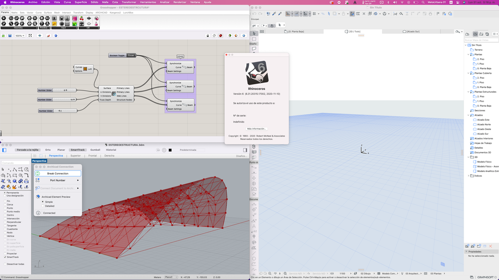

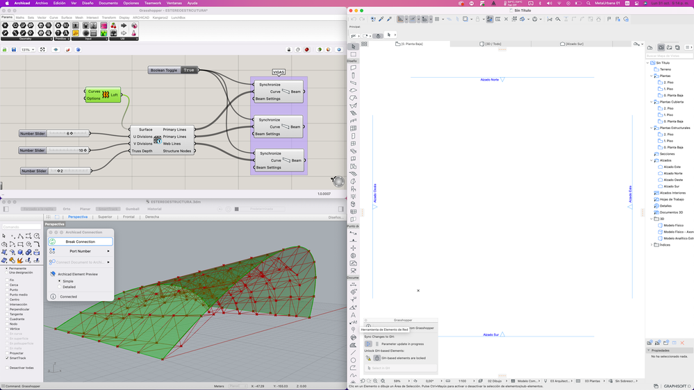

Does anyone know why this error happens on Mac?
What happens is that I need to use rhino-grasshopper and make the live connection with Archicad 25-26, I download and install the live connection plug-in and when doing something in grasshopper it is not reflected in Archicad, however, Archicad does recognize that there is a connection. I have already tried to test different versions and I have also installed the live connection plug in for each version they all have the same error.
In a post on this forum, I found that a possible solution was to modify the name of the file found inside the path /Users//Library/Preferences/) and rename it from:
com.mcneel.rhinoceros.7.plist to com.mcneel.rhinoceros.plist
But this didn’t work. Below are some images of what happens. I thank you in advance for your help.

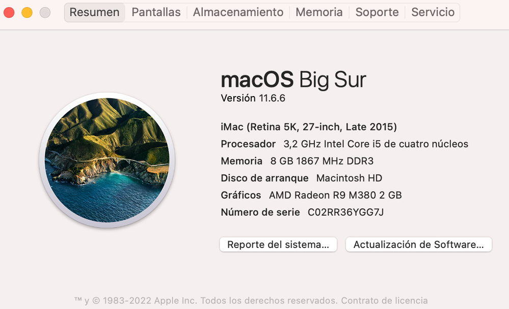

Which version of Archicad are you using?
If it is AC25 version 5010 and above you will need to run the Archicad installer again after running the Grasshopper installer.  The Grasshopper installer needs to be updated to match the current release of the AC version you are using.  I am about to start using AC/Grasshopper connection for 26 so the process I will be doing is uninstalling the AC25 /Grasshopper connection using the uninstall program found in ~/Graphisoft/Uninstall.GC/Uninstall.App.  Then I will run the AC26 Grasshopper connection installer and then run the current release of AC 26 version 4019 (or later if people read this later than the 25/10/2022).

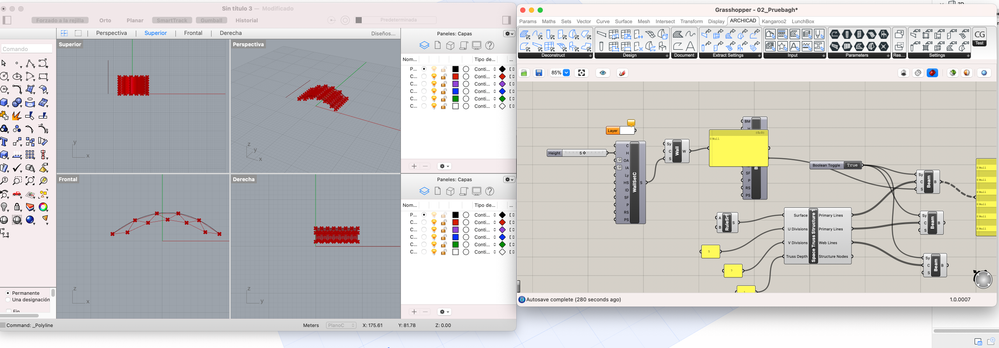

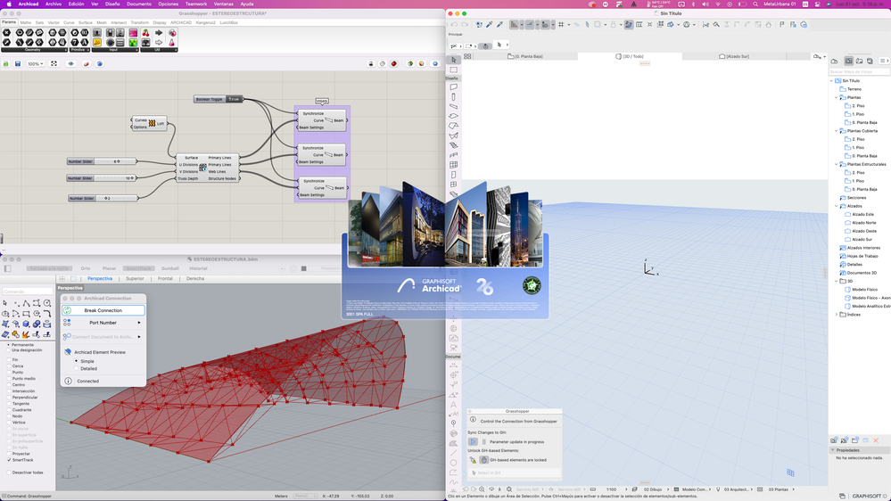

Hi! I have the same problem, it shows nothing on AC26 SPA 3001, using a MacBook Pro M1. I was able to install the AC-GH Live Connection for AC 26 3001 the connection between programs it's fine but it's not working, the meshes i get is only visible on Rhino windows and not in AC.
I did reinstall so many times, it's so frustrating 😑
Also, i tried with the AC 26 3001 INT version and the AC 25 3011 INT and it still didn't work either.
I tried all of that Sebastian wrote but the problem remains.
HELP! 😫
Archicad 26 MacBook Pro M1 2020
Captura de Pantalla 2022-10-31 a la(s) 5.14.58 p. m..pngCaptura de Pantalla 2022-10-31 a la(s) 5.16.44 p. m..pngCaptura de Pantalla 2022-10-31 a la(s) 5.16.37 p. m..pngCaptura de Pantalla 2022-10-31 a la(s) 5.16.27 p. m..png
