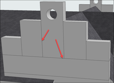

My first attempt at Param-O.  It is cubes stacked on top of each other. Is it possible to remove the black lines visible on the image?
They are visible when I use other surfaces to, so telling me to change line color will be apliccable to this view only...

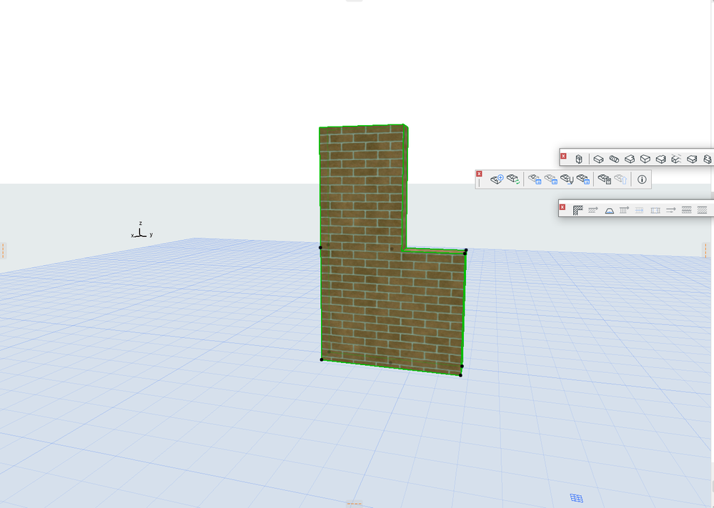

Do you mean something like the one in the first photo?
have you used the union node (the one in the second photo)?
I have not, and it worked like a charm.
Thank you!
