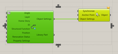

Hi, is it possible to choose an AC Object to place based on a GH script? It seems we can create a new Library Part, but if I set the component to 'Use existing Library Part', is there a way to pass it an object name that it takes from somewhere? Or do we need to 'hard-code' each instance of it?

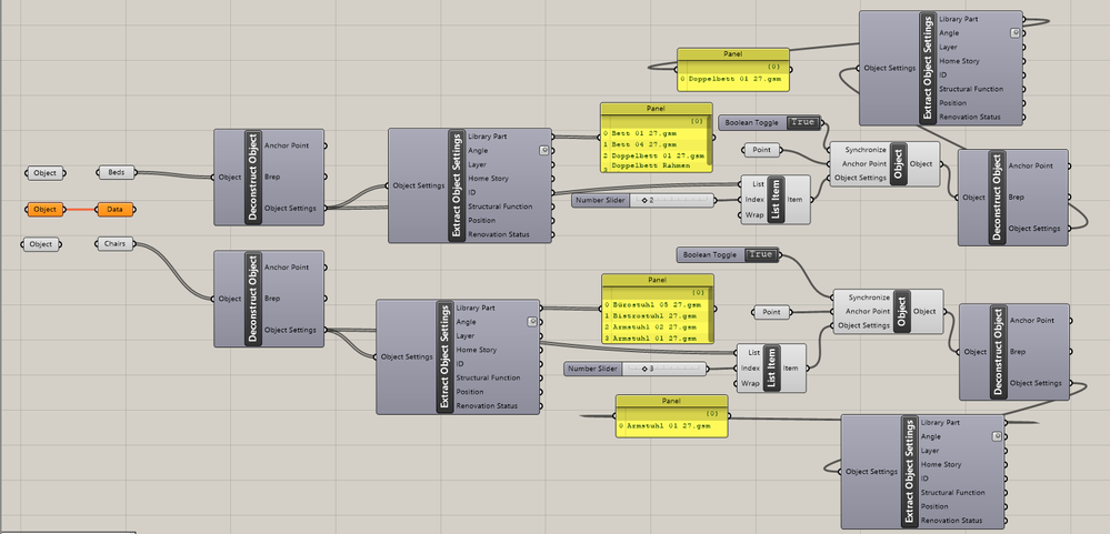

To have a bunch ob objects available to choose by criteria given from GH script I have this Workaround:
I place all my needed objects in AC and in GH I set an object node for each type. Then "Set multiple objects in Archicad" will bring them in. Afterwards I'm going to set "Internalise Data" and delete my placed objects in AC.
Now you have a "Library Node" named to the types it stores. From this point on you can set your code to manage what and where will be placed (e.g. if Room number is xx then place object yy).

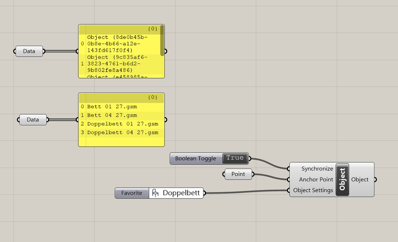

Thanks, this might have potential. Unfortunately I can't get it to Internalise the data - the option is greyed out on the original Object node. Connecting it to second Object node and internalising that one got me some of the way, but it still failed once I deleted the original reference objects in AC...

Mea Culpa...I opened the GH file again and check the stored object. The problem is that when you delete the objects only the Tag (ifcidentifier) will be kept. And this is a unique number! I've managed to get the names stored but this will be text only without any capability to connect.
Now I'm back to the favorite node and far away from automatism😒. But I will not give up....

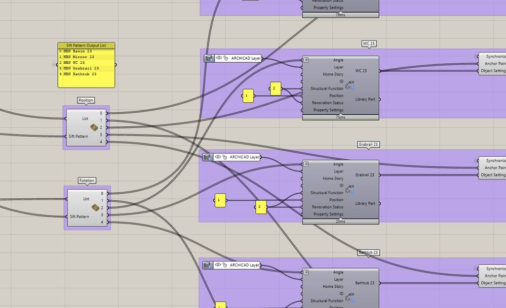

Thanks, glad it's not just me! I wonder if another tactic might be to preset all possible objects used in the script, then pick them using something like Sift Pattern. Only problem is that we might possibly be using any of about 100 objects for this task...
