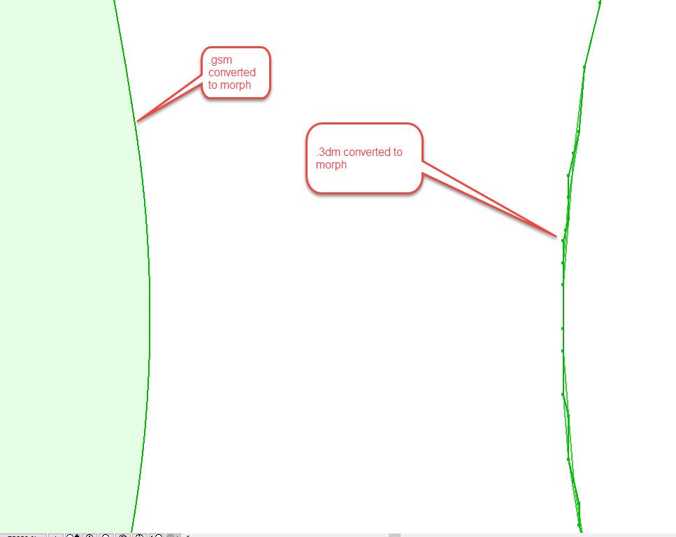

I have been testing this add-on and it seems to me that I can get much smoother results, however, I am not sure this is from the add-on or just tapping into what ArchiCAD can already do. ? Using base molding for a test, I can get smoother curves with a .gsm than for the .3dm

What you are talking about is another thing: the accuracy of geometry coming from Rhino to ARCHICAD. I will report that issue to GRAPHISOFT.

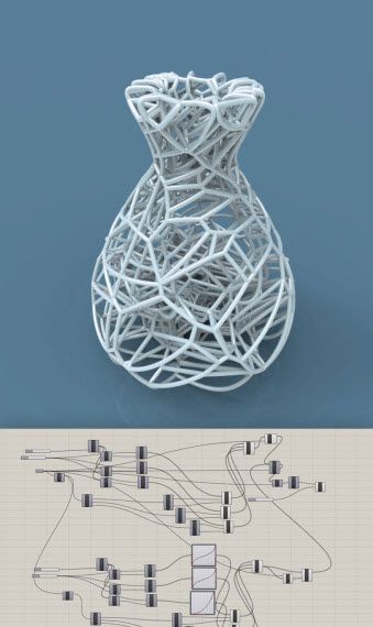

Attached is a picture of come Grasshopper graphic representation of the codes to be applied to various elements. Does that look like something you want to do ? This is programmer candy, not modeling tools. Unless I am not understanding what this is. ??

The example you showed in the attachment looks pretty complex. But in most of the cases it can be much simpler than that. Of course the more complex it is the higher level of algorithmic control you have over your design.
Maybe this is not your cup of tee. It is mine, I find this kind of stuff interesting. These tools are also used by huge ARCHICAD client firms like BIG and NIKKEN SEKKEI who find them very useful.

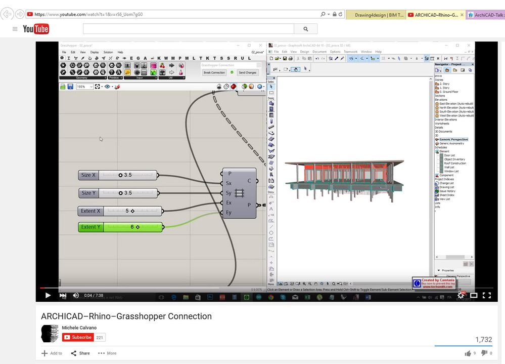

I see - Here is an example of the Grasshopper script and the Model it generates. WOW! This is going to be really cool. It adds a new dimension to working with ArchiCAD. I will keep working with it to see how I might use it for the kind of projects I am working on. Mine are simple geometry for the most part.
Steve Jepson
This is what I was looking for! https://youtu.be/rS6_Uom7gG0
