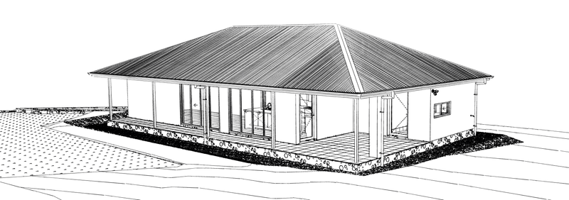

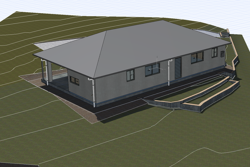

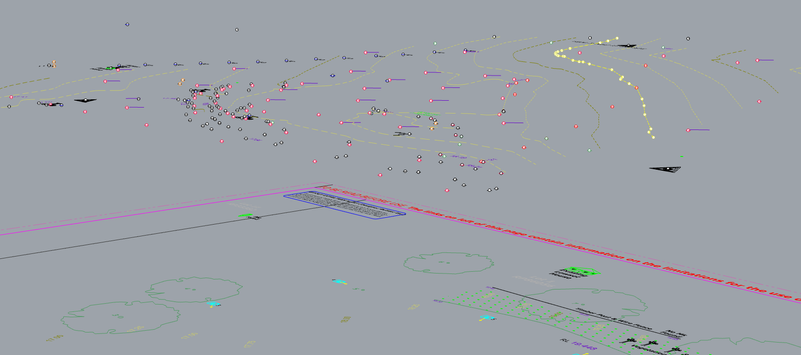

In recent tests, we (Vincent) was using Rhino+Grasshopper to simplify and unify DWG contours, elevated in Rhino, then run through Grasshopper again to get a mesh into Archicad.
We are seeing a major limitation to the Grasshopper plug-in: that only points can be plugged into the mesh script; what we really need is "user defined ridges" as an option.
Anyone have a work-around to get real contours onto a mesh with Rhino? Any GS developers have any influence on expanding this part of the GH plug-in to allow for more usable/versatile/flexible mesh development?
I'll add that Vincent Todosiev (not myself) has been putting in a lot of leg work to figure out this workflow, so I hope he'll be able to chime in here to give more details on what he's done. These are just screen shots I snapped from our last meeting.
